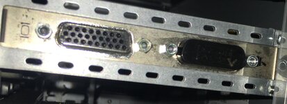

I managed to get a PC Compatibility card (PCI) for $20 (unsure of the exact details of it, it's either 100Mhz or 160Mhz). I installed it in my MDD because I no longer have any early PPC machines with PCI and it mostly works. The PC card boots and runs, can switch to and from the system and the only issue is that it causes the system to crash when I shut down the Mac system. When switching to the PC side the Mac screen dims but I get no PC output because I don't have the video loopback setup.
My question: If I get an adapter for the video out can this port display the video for the PC side to another monitor/cable? I can't install a loopback cable and there's no GIMO slot so it can't be routed to the MDD video/existing PCI video card. The PC card has a different video connector to the early PPC machines (DB15?). Am I correct in saying this connector may be a 26-pin D-sub (DA-26)? If so could I get a DA-26 to VGA/DVI adapter to use for video output?

I believe that's a 100MHz model, as the 166 ones I've seen have two VRAM chips soldered where the 100s usually have upgradeable sockets.

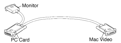

The DA-26 cable is designed for this adapter

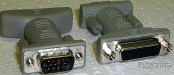

If combined with the relatively common VGA-M to DA-15-F adapter commonly shipped with PowerBooks (590-0322-A)
and of course, another adapter to get back to VGA, you can use the loopback function with the G4 without issue.
If you only want to run a separate display for the PC, a custom adapter which skips the input signals should work. The manual for this card (or the predecessor or its third party cousin, can't recall) even mentions leaving the loopback portion unhooked as a valid configuration for two-monitor use.
The pinout for the 3-way cable is here, but be sure to note the 4-way cable is for the earlier cards and won't work for this one:

That's very interesting!! Thank you so much for pointing me in the right direction, I've bought the parts and will attempt to build my own cable. I can't wait to have it going!
And 166s have DRAM soldered on the back side as well (bottom) vs 100 (top)
Also, the (Cyrix) 166-C may or may not have socketed VRAM, because I've never managed to find so much as a picture of one, save an eBay listing (which also may or may not have been one…ugh). The Apple Memory Guide shows an illustration with sockets, but some of those diagrams aren't completely correct : /

After ordering parts to make a cable I managed to get both variations of the cable for $15! I can't get the loopback function working since I need a VGA (male) to DB15 (female) adapter. After booting the PC I unplugged the monitor cable from my video card, and with an adapter connected it to the PC video cable. I was able to get this output but it's all garbled.
