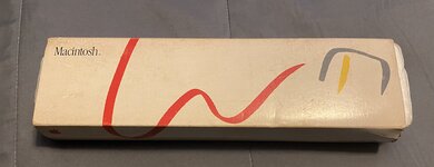

And check this out.
A boxed M0100! I was super excited that I won the auction for this. I have never had a boxed early Macintosh peripheral before, so this is super cool for me.
The mouse was made in the 42nd week of 1985. Initially the button did not work, but it turns out one of the solder joints inside was cracked. Reflowing that restored button functionality!
