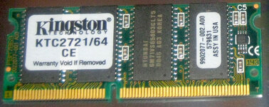

have to open it soon to look for the pram battery, I wonder if I can use one of my old SDRAM sticks in it.
these are pc100, came from a Lombard etc. , as far as I read the original was EDO Ram.
They’re great laptops. The RAM is tricky - you need specific modules for the 2400c, standard EDO RAM does not work. 32/64 MB modules can be found usually on Japanese auction sites, the 96MB modules are very rare specific to the model.
Lower capacity standard EDO RAM should actually be detected. I'm fairly certain 32MB is the limit, and anything over that needs the rare custom RAM.

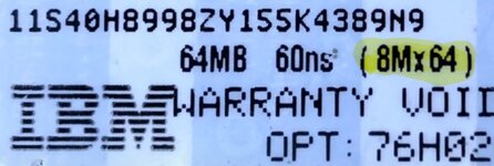

ok, little update on the RAM, I bought an IBM branded, 64MB, EDO SO-DIMM 144-pin 60ns 3.3v stick, after boot in 8.1 only half of it, 32MB are being recognized..ok, better that before, but still strange. ( I cleaned the contacts three times).
I asked the seller and he just went with the recommendation of the standard Apple page that only 32MB are supported.
That would mean even if you have correct period correct EDO RAM, like in the ThinkPad 380/380E (May 1997), like mine, it still would recognize only 32MB. Only Apple branded special RAM would be recogized 64MB or higher, these modules must have a special addressed RAM design.

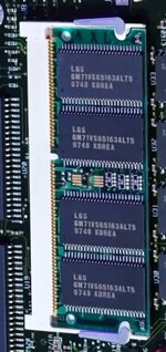

here some screenshots of 64MB sticks featured in different YT videos
you can see these in fact have 50 pins chips on them ( not the older EDO chips with 28)
sean2400-2.jpg sean2400ram.jpg Bildschirmfoto 2024-05-16 um 09.31.28.jpg 2400ram.jpg
the infamous 96MB RAM, 64MB down+32MB on top of it ( distributed on both sides)
