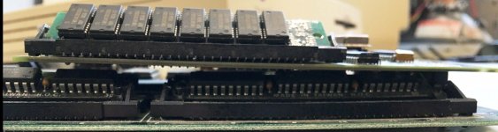

HRMMM? RAM on the Accelerator would be loaded with the video data by the 68020, no? Does the logic board really care whether the frame buffer data it accesses from the same mapped location is physically located on logic board or PDS? I don't recall there being any portion of SE memory buffered expressly for the purpose of video like there is on the IIsi.The logicboard has to access RAM as well because video data is stored there. It can’t access RAM on the accelerator so you need to have RAM on the logicboard.
