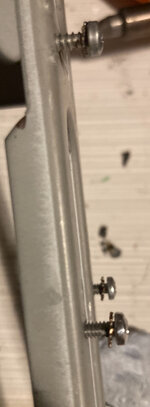

Huh, I'm positive that some of my stash are #4-40. Actually, my ground screw (which fits) looks different than the screw you pictured. The thread is more coarse:
No worries, I'd assumed it was a common screw. After lots of experimentation, I discovered it's the same as the screw that attaches the ground wire from the power supply. I'm going to bring that screw to the hardware store and use it as a reference to get more.
That is some kind of self tapper you have. Make sure it isn't meant to be a metric machine screw of some kind. I can't tell which screw you mean exactly, a picture would help.
Putting a self tapper in a machine screw hole will chew up the hole horribly.

The coarsely threaded ground screw will fit in the finer threaded bracket screw hole, but it does not belong there, and will distort the hole in the process. My screw gauge kit does not have a gauge that fits the course ground screw.
The picture below shows that the ground screw has coarser threads.
Yeah, the finer thread there looks like a metric machine screw. Apple like M3.5 screws which can be tricky to find. If someone can clearly tell me which screw it is, I can measure on from my machine.

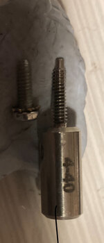

I was under the impression Apple used metric screws, but the bracket screw does not fit any of my metric screw gauges. It does fit the 4-40. It falls out of an M3.5 gauge, and won’t go into an M3.0-0.5 or M3.0-0.35.
Pic of the screw fitting perfectly in the 4-40 gauge, which itself fits perfectly into the bracket screw hole is below.
If the bracket screw hole was damaged by the ground screw, the 4-40 screws that were attempted might not fit.
OK, I will get some more 4-40 screws and try again. I'm almost sure that some of my mixed screw collection are 4-40, but maybe I'm wrong.
I tried to be gentle when testing different screws, not applying much force so as to avoid damaging the threads in the frame. But I suppose that's no guarantee.
Thanks for the measurements!
