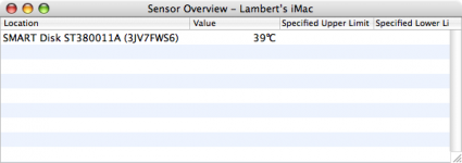

Oh and I wanted to add a temperature meter to monitor the CPU among other things but apparently this iMac doesn't have that much sensors?
