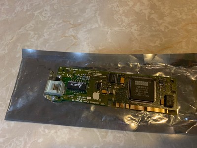

I can confirm that the "Fast Ethernet Desktop PCI Adapter DFE-530TX" Definitely works in a Power Macintosh 6500 both in Mac OS 9 and Mac OS X. It's a 100mb card. The driver is readily available everywhere.
You can zap the PRAM to see if yours shows up again. From past experience, if the card wasn't present during the Mac OS installation then driver support for it will not be installed. For best results install the PCI card so it will be present and do a clean OS installation then driver installation. On reboot Ethernet will be an option in your control panels.
I've been trying to get my 6400 online with ethernet myself. I've tried three different PCI NIC cards, with no sucess. I want to keep the machine on 7.5.5, but it seems like all the drivers for the cards I've tried will only work on OS 8/9. I've tried the SMC 1255TX card, a Kingston PCI card, and a stock Apple 10/100 Fast Ethernet PCI SA0025 from a G3. None of them work...."ethernet" won't show up in the TCP/IP control panel. The cards light up when cable is plugged in, etc....but can't get them to work under System 7.5.5.
Try this
Check your Extensions Folder for PCI Ethernet extension. If it’s not present you’ll need to do a fresh Mac OS install with the card installed. The installer detects your hardware configuration and installs the necessary files. Also for non Apple Card’s you need a third party driver.
