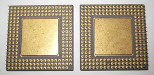

Understood. I purchased 2 of them knowing that was a possibility. I still have one I haven’t tried (which I’ll remedy soon). At the moment I’m getting software loaded, and I need to figure out why the screen is skewed. From what I’ve seen that might be due to a cap on the analog board
This is the pair of chips I bought, btw
I was a bit suspicious because the arrow mark in the corner looks very faint

Those look legitimate from a glance.
I put in the other 68040 processor and it worked. Also, fiddling with the monitor adjustments some more got it straightened out. Now comes all the fiddly work of installing extra software…
