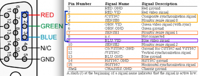

Looking at my IIsi Pivot and the signals on the SE/30 card it should have the following pinout:
Code:
1 gnd
2 red
3 csync?
4 sense0
5 green
6 gnd
7 sense1
8 blue
9 gnd
10 69hz vsync
11 gnd
12 64khz hsync
Not sure on the csync... that signal goes to the SYNC pin on the RAMDAC, so it's possibly correct.
The frequencies on 10 and 12 have been measured without a anything connected to the card, so it seems like it is always outputting something (well, sync signals at least)
The harness for that card in the picture @BadGoldEagle posted only connects the blue signal, hence that fancy trick bridging that signal to the other color pins works.
Green and red signals are routed from the connector to the RAMDAC as well. Going to wire up an adapter quickly and see what happens...
Put together an adapter from jumper wires - the pinout above is correct. Pin 1 is closest to the top of the card (opposite of the PDS connector)

JT737, could you pretty pleaaaaase elaborate a little more on the red-green-blue cable hack! After much reading I finally could persuade my Pivot SE/30 to make me blue. How exactly did you connect the cables?
So in this thread I found a pic provided by 9166188 of the pin situation between DB15 and VGA pinout
Bolle described the pinout of the 12 pins on the Radius card and JT737 seems to have connected the missing green and red lines on the card to the female DB 15 on the Radius clamp. But to which pins? And this approach is different from all the posts before, where the blue signal line was connected to the empty red and green pins/lines on the vga cable side. Since radius monitors are very rare I think it would make sense to manipulate the cable from the card to the clamp on the Mac side in a way, that you get a non blue pic with a standard db-15 to vga adapter. I am scared to destroy anything by connecting the wrong lines and would greatly appreciate, if someone could point me into the right direction how to best solve the blue screen problem practically.
