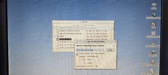

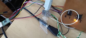

Mini update: I finally build a high-tech adapter for a real localtalk network, and tried everything with MacOS 9.1 which worked well (except copying files to the pc)
My high-tech USB to LocalTalk (not shown the PhoneNet link)
Happy MacOS 9.1 on my PowerBook G3 PDQ. I wanted to try it with my "new" PB150 but it died :(
