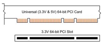

Front edge position leaves room on the logic board of SE for full SD card housed in printed external FDD D-Sub connector "SD slot." Traces for SD lead to the "stock" riser card's connections. With board's PCI-X connector mounted close to front edge of chimney, plenty of cubic remains for any kind of stock backplane breakout board I've seen to date.
SE/30 chassis implementation provides width necessary for full universal 64-bit PCI Card Connector and even more shenanigans.
Looking for feedback on how to best approach this. Suffice it to say that no stock Compact Mac boards are involved in this craziness. The only "original" Compact board would be the SE as it's in dire need of a PDS passthru for a VidCard when something nasty like a slot hog of an accelerator plugs up PDS and cuts off access to its single interrupt. 😬
