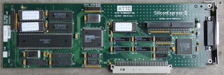

That must be a slightly later card than mine, as mine still has the Emulex branded FAS101...
Edit: Also really interesting to have a shot of the SE 1, as I'd not seen one before, even more interesting that the SE 1 and SE 2 appear to be effectively the same card...
The two parts with labels on the far left of the card will be upper and lower ROMs for the 68000.
Indeed. The two HY6264A Series parts to their right would be low power, non-volatile SRAM for faster memory on the 68000 subsytem. Is there a trickle charge available on NuBus when asleep or shut down states or would they just be loaded load from ROM at startup?

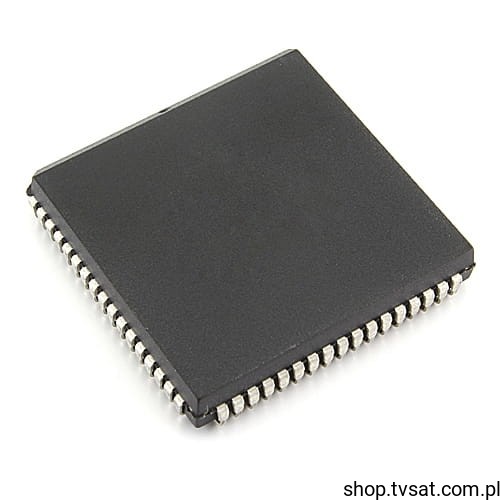

edit: just how small can the CPU subsection become with current SMT parts, quarter sized? SMT 68000 package is pretty dang small in comparison.
Assuming here that ROM/SRAM packages would be same reduction is size of smaller yet?
Not sure how I was unclear.... you can not remove or replace the NCR 86C05 DMA & Nubus controller, it is foundational to the card's architecture and can't be handwaved away. Without it, none of the original design will work nor could it be made to work.
Is there any insurmountable problem with excising the entire NuBus interface and doing whatever necessary in order to hook the remainder of the card directly to the 030 PDS? AI playtime commences. :p
Methinks @Melkhior might have some interesting things to say about getting around the card's NuBus implementation bottleneck?
That is exactly what I'm saying. You excise that controller, which is the nubus interface among other critical functions, the card ceases to function as a coherent whole and the parts that are left are unusable. You would need to 100% replace it with an identical implementation in a FPGA if you wanted to make use of the original code.
Otherwise, you're building a new card from scratch with all that entails.
