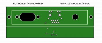

Youve probably thought of this already, but what the heck?
Mounting your breakout board backwards allows an RJ connection to Vonets with mounting point for antenna and a little something extra. Empty holes are for bolting up a soldertail VGA or other connector, nothing but empty holes required for an in cable converted Radius Color Pivot II/IIsi breakout.
LOVE your project!
edit: oopsie, delete the GA and substitute "onets" :blink:
