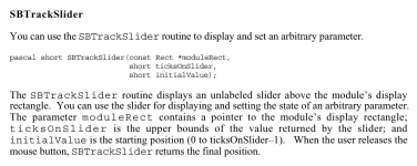

And here's Apple's documentation about the slider routine:

Are you sure that gb->sliderSetting is valid when you call SBTrackSlider()?  What happens if you always use an initial value of 0?
Are you sure that moduleRect is correct when passed into SBTrackSlider()?  (Actually this was my first thought when you mentioned issues with the popup menu also.)
Are you sure that gb->sliderSetting is actually coming back from SBTrackSlider() incorrectly — is it possible that some later point in your code is overwriting it somehow?  Not sure how you’re debugging this.  Do you know how to use Macbug?  It would be interesting to see what’s happening inside the call to SBTrackSlider().

Regarding your first point, I realize now that I forgot to initialize sliderSetting to 0 when I went back and modified Apple's example. It is however initialized properly in all of my previous tests, with the same result.
moduleRect is provided by the Control Strip software, so that shouldn't be a problem I think. And sliderSetting is only used where SBTrackSlider() is called.

It looks like my suspicion was correct and your statusRect is somehow getting nuked. SBTrackControl has no idea what to do with the nonsense Rect so pukes back a negative value. Here’s the statusRect Macsbug shows you passing in. I got this by noticing that you are putting the Rect at an offset of $000C to A6 on the stack for SBTrackControl, and doing “DM A6+C Rect” in Macsbug. I’ll look at your code again later and try to figure out what’s causing this.
OK I'm pretty sure the problem is in this weird implementation of DrawCurrentIcon.  Is this really Apple sample code?
This writes over the statusRect that was passed in by MacOS.  That seems weird.  I think this code should allocate a new Rect on the stack, set its coordinates, and call PlotIconSuite/DrawPicture with that.  What happens if you try your control strip module with all the lines after "arrowHeight = ..." commented out?  I think you should avoid every modifying the statusRect that gets passed in by the system and if you need to draw things elsewhere, set up a separate Rect on the stack or that.
From the Macsbug screen above, it looks like statusRect->top is good, and everything else is nonsense.  When I run this multiple times, statusRect->left and bottom are random nonsense values; statusRect->right is always -256.
