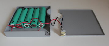

Hey, so I built the 3D printed pack their for my PB 150, thanks so much for making that, it looks great! I have to ask though @Westinghouse, whats up with the little tab thingys for holding on the battery cover? They aren't even close to the correct shape for the PB150 cover, is there a model that that's the right shape to hold the cover on?
Hi jinnai;
Thanks for the kind comments!
The tabs are only there as standoffs to hold the battery secure within the recess against the back of the original sliding case cover. I didn't feel that I'd be able to get the original sliding cover to match up well with a printed tray's sliding cover tracks without doing several rounds of prototyping - and since I don't have a printer of my own, this solution was good enough for my purposes... so the sliding cover from my original battery is a separate part from my printed tray.
They also double as fingerholds so that I can pull the printed tray out when the sliding cover is removed.

I 3d printed the battery case @Westinghouse designed (I'm not sure if he's still on here but what an incredible job - I was astonished at the extreme level of detail to allow for clean routing of conductors).
This pseudo-battery worked great with my PB 145B and 5x NiMH batteries for a couple of weeks.  Note I was NOT charging the batteries in the Powerbook and continued to remove them and charge separately.

Hi Superjer2000; thanks for the kind words about the case design!
I am on here every once in a while.
Regarding your issue, I wonder if perhaps there is no longer good contact between the battery and the contacts inside the powerbook.
This might not be the case for you (I'm still using my original, before I added the 'lid'), but it would not hurt to check: maybe the case warped a bit under the physical stresses of the cells and cell contacts; I had this to some extent, and I soldered some additional copper over the battery-to-powerbook contacts to ensure good contact.
