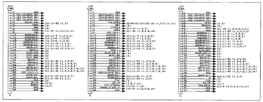

For the other signals I mentioned above, here is the pinout of the PDS connector:
It would be interesting to know what happens on the +5V lines (5/0 --> this powers the CPU, 5/3.7), SYS_RST, SYS_PWR.

Thank you for the diagram. That makes things much clear as to what have to test. I assume 5V line is the pin 25 on row A of J12. I will wash the board first and let them dry properly before doing the suggested test. I will report back once I completed the testing.

As suggested, I tested the J12 pins (all are with computer powered on):
+5V VCC(5/3.7) on J12 row A pin 25 showed 5.19V.
SYS_PWR on J12 row B pin 5 showed 0.006V
SYS_RST on J12 row C pin 30 showed 0.476V
I should note that when probe of multimeter touched SYS_RST pin, screen changed from black to bunch of lines (no legible text or symbols).
sounds like the PMGR died. might need to isolate and control those lines seperately just to see, but youll get a CD34/CD36 sad mac regardless.
Thanks you techknight. That was what I was afraid of. Given that PMGR chip is pretty unique and surface mounted chip, I will have to leave this as non-working computer for now.
