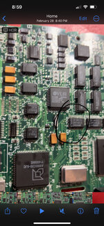

I would focus on areas in circles. Als 245, the ram chip and the one rom chip

almost all of the iisi boards i have had and recapped had issues with two of the als245 one at each end near caps, the one memory chip closest to cap and the one rom chip. Also check traces near the cap near processor. Had bad traces there too. These were some of the worst offenders boards i have had
