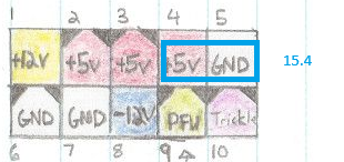

In this image I marked the continuities that I found
I think the SCSI continuity is fine. I believe those are ground wires. However, the power connector and capacitors you marked suggest a short across +5V and ground. If all of the pins on the hard drive connector really are shorted, then you also have a short across +12V and GND.

I would recommend measuring to see exactly what the resistance reading is across +5V and GND. It's actually very normal for Mac logic boards to have a low enough resistance there that your multimeter will trick you into thinking it's a short. My IIci, for example, measures about 16Ω. Others have reported similar results. See this link (and my subsequent reply) for more examples.

back to the topic, it makes sense to get these readings with what you just told me, between these two points I found a resistance of 15.4 in my case, and my multimeter beeps when the resistance is less than 30Ω, I tested capacitor C4 which is supposedly shorted and it has 15.4 resistance, which is a good thing, all the capacitors I marked have the same resistance, also the molex pins, which is something that reassures me a bit.
