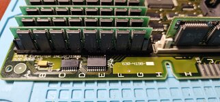

So their is couple for the memory, for me that will cause the Simasimac display no the solid white screen. Correct me if I am wrong!Don't remember, but can be related to Bourne Filters

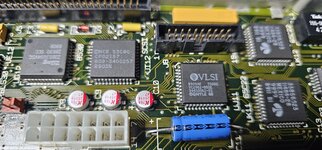

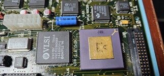

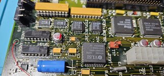

The Recap was done by the owner, trying to get it working for him. I removed all of them and put them back. so far i dont see any issues with them. Continuity check has been done in all of them to verify. No issue so far. Anything else!Did you replace those big axial lead capacitors? If you did, check the negative lead on one of those big through-hole axials -C2- where it goes through the hole on the top side of the board. The hole / lead on the top is literally a hair's-width from a trace running next to it and when I redid mine I ended up with what looked like a normal sized tiny dome of solder on the top side of the hole at the base of the lead, but it was just enough to connect to that trace beside it and hold it low which gave me the same symptoms. I had tried everything as I couldn't see the miniature bridge there, thinking that trace might have actually been a designed connection as it was so close and disappeared under the solder dome. But then I decided to start taking things off that I had added, one by one and when I took that cap back off and wicked the hole clean I noticed the lead actually wasn't supposed to connect there. So I carefully put that cap back and made sure no solder appeared on the top side and it booted right up. Then I painted over that tiny nick in the coating with clear nail polish.

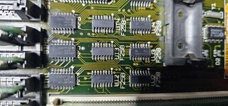

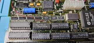

Yes, but if I am correct, that will give me video artifacts, not the behavior I am getting....UE8 looks to have crud under it still. The rest of the board is very clean indeed. Sometimes that whole row of chips needs replacing.
Thanks! Will check the lines again!Hey just throwing in my two cents -- I just experienced this on my board and was able to fix by making sure the ADB (UL11) was good. As I understand it's also possible for bad connections to the SWIM or SCSI to cause this. Might be worth checking those lines if you haven't yet. Best of luck!
