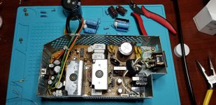

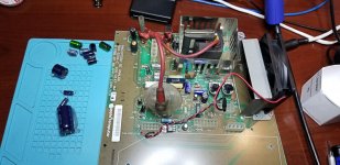

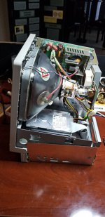

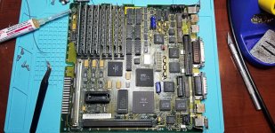

Got it Installed and working, thanks everyone, I created my own disk image using Basilisk II. My SE/30 have a clean 32bit ROM and 128mb of RAM, so I needed to be sure that the image was patch special using 7.5.5. I will try 8.1 soon, now that is just swamping the SD. I 3D printed a mount to be able to access the SD card and upgrade firmware...came out really good...still a work in process...added the headers for the LED light!
