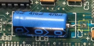

I’ve attached a picture of the logic board:
(this is without the RAM, ROM and video ROM; I removed them to see if the display would change, but it didn’t)
broken traces. check them.
I noticed a couple nearby C11 where you replaced the capacitor.
Also check the traces and vias aruond where the battery was.
Pic is a bit blurry there but I think I see some rusty/greenish vias and a few traces where the stopmask seems to get lost due to corrosion of the traces underneath.
A lot of address and data lines between ROM, RAM and CPU passing along right there.
Oh yea I forgot, this is a battery damaged board.
and Bolle is right, but, ALL of the ROM/RAM/CoPro traces run there. they are likely broken which is why its not booting.
I would also look at C2, the amount of solder looks meager. I would check continuity on all the caps but definitely C11 has no holder at all.
