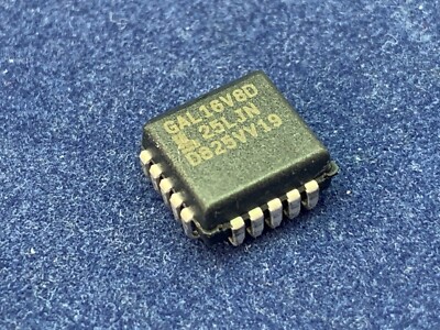

- The PAL ICs at UI6, UG6, UE6, UG7, UE7, UH7).
