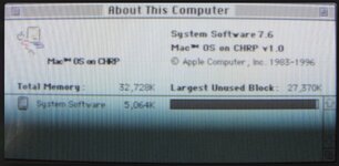

Done some digging, and looks like some clone prototypes came with this special CHRP version of Mac OS 7.6:
Maybe it would boot a Beige G3?
Not archived sadly.
That was from the Motorola StarMax 6000, I believe, which I think did use the Grackle PCI controller.
There is a chance it could be made to work on a Beige G3 (I wouldn't be surprised if Gossamer is a direct descendant of whatever they designed for the SM6000), but obtaining that version of Mac OS would be the major issue, of course.
technically the two known CHRP copies of MacOS were from motorola viper dev units. i believe that board was adapted for the starmax 6000 but i can't remember for sure. digging in some old magazine scans on vintageapple.org or archive.org should turn up the truth.
