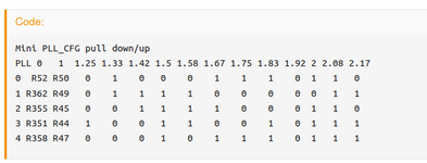

Once this is done, you just have to change the PLLs that adjust the speed of the CPU. Like everyone else, until now I did it by adding or removing resistors from R52, R362, R355, R351 and R358, but @herd told me that this is not the correct way, as can be read in this fragment of the datasheet, it must be indicated correctly the pull-up or pull-down, and in this way, the adjustment was "in the air" and any variation in tension could cause instability.
The correct table is this one, which Herd provided me, where it indicates that when removing one resistor, another must be added to its opposite one, and vice versa.
