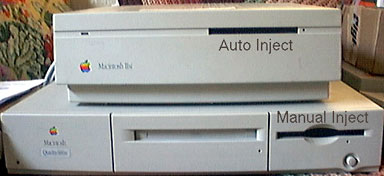

Edit: an additional point on the Centris: IME, auto-inject floppy drives are much easier to maintain, if that's something you'll use, vs something like a BMOW FloppyEmu device.
Good to know...the one in my iivx works fine it had some issues ejecting out fully but it was just full of dust. It ejects consistently fine now
