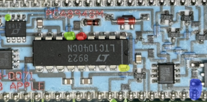

Right after I reconnected the battery I read 1.22V on the comparator green pin, .06V on the red pin, 7.51V on the yellow, and the blue pin now reads battery voltage at 6.45V
the op amp to the left then showed green 1.22V, red 1.49V, yellow 0V. I then was able to get the short squeal from the speaker, and a sad mac on the screen but not every time. I could unplug the charger maybe hit reset and sad mac would show and disappear - maybe unplug the battery, plug it back in, hit reset, then press space bar and sad mac would show up again! Crazy
Today after the board was plugged in for awhile I noticed the reference voltage on the comparator (green) reads 0.65V - the red is still 1.49, the yellow is 7.51V, and the blue pin still reads 6.45V.
Seems like something is degrading

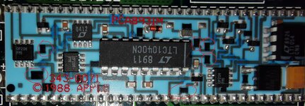

It might be the "painted" resistors.
On mine they are degrading, even after the mainboard got recapped and everything got thouroughly cleaned with ipa and distilled water.
The portable still boots, but is saying the battery is low, and then most of the times will shut off, eventhough voltage on all the pins of the power connector is close to 7 volts with the charger connected.
The resistors are those black "rectangles", usually with one or two tiny small scratches in it (done to reach exact resistance I assume).
Blow is the picture of the hybrid when I got the portable (and it was working perfectly, before the recap).
After I recapped it, and super thoughly cleaned it, the hybrid kept deteriorating to the point where the rectangles are now sort of rounded...
I'll see if I can make a picture of the current state, then you'll see what I mean.

The resistors look fine on this board - no damage, no degradation. It seems as though this hybrid board is bad but I certainly don't want to replace it without being sure. SuperSVGA has good knowledge but I know it's hard for him without seeing the board.
I know pin 8 is supposed to send voltage to the gate on Q16, but it's not for some reason. Q16 reads gate 0V, drain 7.42, and source 7.42 - which is strange because I think Q16 drain is supposed to send feedback to op2 to show enabled ram/ttl and 2nd stage mosfets so does that mean it thinks its on? I still can't figure out how 5 volts is non-existent on this board either, all I see is full charger voltage. Hope there's someone that can make sense of this :)
You're seeing the full battery or charger voltage because the MOSFET isn't getting any voltage on the gate. At 0V it will just pass through the full voltage to the +5V. Normally you'll see around 2-4V on the gate, though it varies a bit.
