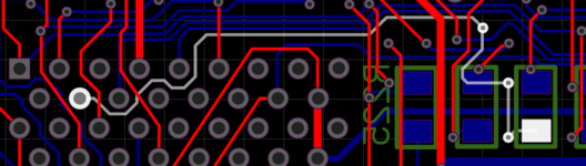

If anyone has schematics for the video chip U15D that would be amazing! Or know where the video lines under capacitor C11 goes to. Those pads on mine are completely corroded. Video circuit for the backlit seems to be completely different from the non backlit and it's gonna be a few nights of beeping party :(
The video circuit should be mostly the same. They just added in the brightness control potentiometer and disconnected the contrast (the trace is still there but it no longer connects).
Are you able to show which traces you are looking at? The traces under C11 are data/address lines along with reset.
Oh, that makes sense! It just seems like so far from measuring the pins on the bottom row of the lcd connector J19, they all go to different pins on the video chip for me 🥴
Hmm, maybe it's not those then! I'll have to get some pictures but I can't find damages elsewhere on the board.
Is it possible that I have partially damaged the video chip or video ram? I did try to plug in the screen to the board once when the power was on and that caused the whole system to crash. I would imagine that I wouldn't get any display in that case right?
It's hard to see on the picture, but it looks to me like you're not getting video D3 to the display. Check the path between that pin on the video connector to R171 on the back side, then to the video chip from R171.
Ahhh, that is the line that is under C14! It's connected but shorted to ground. I need to redo the soldering under that cap. Thank you so much!!
