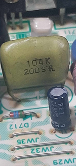

That cap looks a bit rough. I heard recently, maybe from Adrian's Digital Basement, that a bulging appearance is normal for those large caps with the plastic bit covering the top of the cap, and it is not necessarily a sign of leakage. That one is bulging quite significantly though, it would definitely concern me. When I have recapped IIsi PSUs I have always replaced the large caps even though people say it is not necessary. I figure as long as I'm in there, and already ordering parts, I may as well do it for peace of mind.
