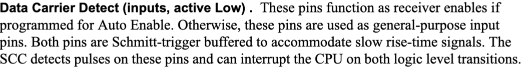

The SCC manual says about DCD:
"General purpose input pins" sounds like what we need. Now, I don't think you'll be able to read this via the AppleTalk driver but don't forget that the SCC's registers are memory mapped. So I think you can peer into read registers without interfering with the workings of the AppleTalk driver, and what you want is in read register 0.

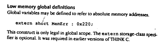

I think THINK C is doing some magic here... SCC* are defined in SysEqu.h which seems normal:
SCCRd = 0x1D8, /*[GLOBAL VAR] SCC read base address SCC base read address [pointer]*/
And then in LowMem.h which seems... strange c:
Ptr SCCRd : 0x1D8;
I found a terse explanation in the manual:
My guess it that it's some sort of extension they have? It is handy, but absolutely non obvious!
