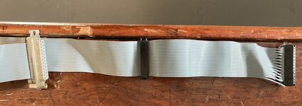

Once that works, I'll move on to the internal SCSI connection. I think there is a cable problem. It's pretty ragged around around the connector and the cable appears to have a break (or two).

Here's a picture or two of my cable problem. I've never tried 'knitting' one of these before. Has anyone seen something like this or is this custom?
I'm game to try and build one, but if something like this already exists, I'd rather get out my wallet.
