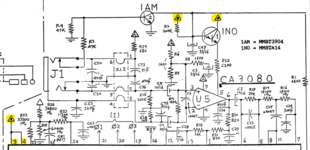

I am trying to fix a no-audio issue with my LC III, I removed the sound chip to clean underneath and check for broken traces. I used the Bomarc schematic to check continuity and everything was fine except pin 3. Per the schematic both pin 3 and pin 4 go to +8v. Pin 4 checks out, it has continuity to R2 and U4 pin 1, both of which go to +8v. Pin 3 has no continuity to R2 and U4, and also has no continuity to pin 4. Based on the schematic pin 3 and 4 should be tied together.
Does anyone know if the schematic is accurate? Or if someone has an LC III handy, could you check for continuity between pins 3 and 4 of the audio chip? Thanks for any help!

Is this something I can fix by bridging pins 3 and 4, or does pin 3 need to get +8v from somewhere else? I am not clear on where +8v comes from on this board, since the PSU outputs +5, +12, and -12. The schematic seems to show two transistors, 1AM and 1N0 that are involved with the +8v power, but I don't know nearly enough about electronics to know what's going on there. I also wasn't able to find those transistors on the board. The triangles with the dot in the center below are +8v. The only other place on the schematic I have found +8v is pin 1 of U4.

8V power is supplied by a 78L08 (U4) -- see below. The transistors you highlighted are used to connect/disconnect the mic amplifier when the microphone is removed/inserted. Avoids amplifing stray electrical noise when no microphone is attached.
