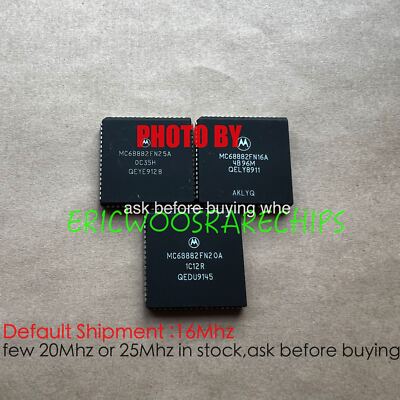

Eric Woo’s listings on eBay are legit. I have bought other chips from him and other members here have purchased from him as well.
But be careful and check the eBay ID as I have seen other sellers reusing Eric’s pictures.
Eric Woo has an excellent reputation and the stuff I've previously got from him has been sound.
He's not immune to his suppliers sending him crap - but then who is? - but he seems to deal with that situation well when it occurs. And that's about al one can ask.
The 68882 from Eric, along with a full-fat 68040 33 MHz to stuff into my Quadra 605, arrived while I was out of town. Finally got them installed (removing the LC 040 from the 605 was nerve wracking!) and both seem to be working flawlessly. I'll be getting my chips from Eric from here on out.
