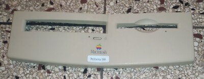

I'm not game to try to remove the front panel from my 575, but I found an auction for a bezel on eBay that shows the back of a 580 bezel reasonably clearly:
