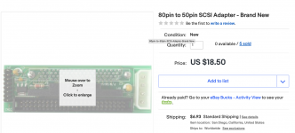

Thanks!  Not sure why I haven't heard of the adapter/2.5" ultra320 combo before but I'm glad I just did.  $32 shipped for both is what I paid.
The adapters quoted are the exact adapters that I use. It seems they have gone up a little bit in price though! They work like a charm, just make sure you have a terminator on the end of your cable since these drives don't do internal termination.

I've used these as well with surplus 2.5" SCA server drives. The drives can get a little warm but since they are 2.5" in spaces generally made for 3.5" or bigger drives, "stock" ventilation is usually enough.
I use in-line terminators at the board (cable->terminator->board->SCA drive) and this seems to work fine.

Just a warning that not all SCA to 50 pin scsi adapter boards are the same. I struggled for months trying to buy ones that worked with the Mac. At the present time there aren’t any on eBay that will work properly with a Mac.
I found a place that still stocks and sells them. It’s at Datastoragecables.com. You have to make sure your board has 3 rows of terminators on it. Many on eBay say they have termination but when you receive it, it’s not the same as what was pictured. I know because I bought some from pretty much every seller and I have a box of adapter boards that just don’t work.
Ive bought nearly 50 of the boards from the supplier above and they work perfectly.
