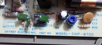

Here's a close-up of the tape covering the input wires and circuitry. This looks to be the relay that passes power through to the Mac Plus when the BackPac is turned on.
Power supply label. Skynet is real.
