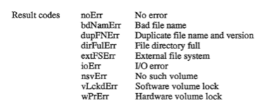

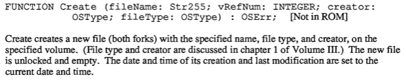

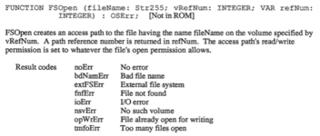

You'll need to find the vRefNum if you're not using StandardPutFile or StandardGetFile dialog boxes to choose a file. I do know how to do that, but I have to dash. Do you have a link to Inside Macintosh Volumes 1..3?
Fair enough, I prefer that too, it's just that you were talking about malloc recently, so I thought you might be using the standard C library. Anyway, if the file exists...
Thank you, I took a look at your screenshots and I probably know what I should do, do you mean you can't find volumes 1 to 3?
