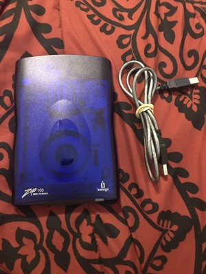

cheesestraws, well this one;

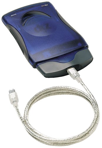

Pretty certain that connector, which looks a bit like SCSI 2, is actually used for firewire and PCMCIA adaptors - this could certainly lead to some confusion.
edit: like this
Also the first external "ice blue" Zip 100 drives had what I beleive was an IDE interface visible (but unpopulated) inside the case
@aladds is correct: I have had one of these drives since it was new, and that extra SCSI-like port is to connect the FireWire adapter on the back. I have one.
thanks, interesting to know that iomega made two different kind of firewire adapters (the scsi-bridging one for the jaz drive and apparently also this other kind for the zip drive)

Here is a good online photo of the drive with the FW adapter attached:
