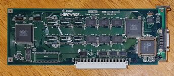

Have you given the pins on the PDS connector a good [IPA] 'scrub'? Of course, don't be too rough, but the above makes me wonder if it might be less-than-perfect electrical contact with the PDS slot?I popped the card back in ... I don't get the weird desktop picture color corruptions at all
