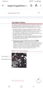

There is also a color ribbon alignment test found in the IWII troubleshooting part of the owners manual. Might want to try that out.

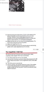

Photos taken from the manual PDF.
Not saying it is your problem, but won't hurt to check. Might only need a little adjustment.

I ran the aforementioned self-test. I think I'd be hard pressed to get anything batter out of a 35 year old machine with no recap and no maintenance! Maybe it is something with the way the overlap happens in the program I am using (Print Shop Deluxe).
