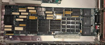

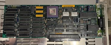

Based on that, I'm going to recap the PSU / replace the fan (based on https://longview.be/macintosh-iifx-astec-power-supply.html), and recap the surface mount electrolytics on the motherboard - but was wondering if there's a good way to connect a IIfx to a HDMI monitor? It appears to have both a 820-0198-A7 Mac II video card, and two other cards I can't identify (pictures below if you can help!). Thanks in advance!

the two mystery cards appear to be a video card of some sort, and an ethernet card.
