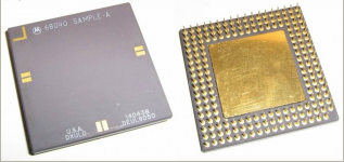

Things just keep getting more interesting and I need some input. Has anyone seen a NeXT Cube board with this kind of chip in it? Mine is NOT soldered into place and says "Sample-A". It also does NOT have any other markings like the other photos I've seen. Can anyone shed some light on this... I have a preproduction board?

NeXT saved money by stuffing engineering samples onto their boards as well. Nothing new there and there's been a few 040 boards with a socketed 040. Nobody really knows why but they don't seem any different.

So then, in theory couldn't someone such as myself with the socketed chip purchase a 68040 33Mhz or 35Mhz and just stick that bad boy in?
Just stuffing in a higher rated CPU won't make it faster. During this era of computers the rating on the CPU was just an indication of what speed the manufacture was guaranteeing it would operate at under "reasonable" conditions. A 33Mhz CPU will run at 25Mhz unless you change the clock speed fed into it, and that may or may not be trivial on a NeXT Cube. (Seriously, no idea, never owned one.)
These days, of course, different speed-grade CPUs usually operate at some common bus speed while a (usually-)fixed multiplier inside the CPU dictates the core speed so your confusion is probably forgivable.
NeXT's do not handle the 68040 the same as a mac would which also means that all the socket accelerators available for the 68040 (EG: the Sonnet QuadDoubler) will not work. There were two different accelerators designed exclusively for NeXT called the Pyro and Nitro. Both are extremely rare and sell for upwards of $5000 when they go up for sale.
On the other hand, It's possible to use the QuadDoubler's MC 88916DW80, a 40mhz 040 and some serious hacks to speed boost the color turbo's to 50mhz. 8-o
