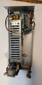

The 220V AC to 12VDC is a 120W transformer for LED strips.
The picoATX is 90W.
In the original setting the PSU could turn the CRT as well.
In my case it is collected directly to the 220C in (not shown in the photo)
Since I do not use an external cards and an internal HD I believe the power provided is enough.

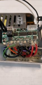

IMG_20210110_123604.jpgThe PN2222A is under the picoATX.

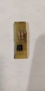

Hi everyone, just wanted to say a big thank you to everyone on this thread specially @Von for the photos of his labelled PCB of the soft power. THANK YOU EVER SO MUCH GUYS :) You saved my Quadra.
Parts used
300W Seasonic SFX SFB
Manufacturer code: SSP-300SFB
PN2222A NPN Transistor
1K and 10K Resistors
Small PCB
