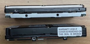

So... I open up a 540c I had laying around for parts... 1st off it had a PCMCIA module.. Score 1... Not sure what version... So I was going to swipe the hard drive from it for another machine... and I look at it and it is an ATA drive??? I'm like wait... an IDE drive in a PB540c.... nahhhh....
There's an adapter daughter card on it!!! It's an IDE->SCSI 2.5 bridge board!!!!!!!! Crazy... never seen one of these!!!!
Anyone else seen em???
Says Copyright ADTX on it...
Im not a huge PB collector, but I cant recall seeing any mention of this. Certainly opens up possibilities.
They shipped with these occasionally, I think when drives ordered were larger than the scsi drives available at the time.
Someone who experimented with these in the past found they will take up to a 4GB IDE drive without burping.  And, of course, with the right adapter, you have the option of using a CF card.
Wouldn't work with a 4GB CF card... but worked fine with a 2GB... I even tried to partition the 4GB into 2 drives... still no go... it just didn't like 4GB even if I left the rest as free space.. But now running great with a 2GB CF
See if a modern utility will do an align=1024 on the existing formatted partition. Otherwise youll get random corruption issues. Trust me. Ive never had much luck with CF, so i started using IBM Microdrive CF cards which are physical HDDs, and they work perfect without failure.
I'm pretty sure I've got one of those kicking around in my parts. I've yet to find use for it. I remember picking it up on eBay for a 180c I wanted to max out.
Hang onto it... I re-purposed mine with a cheap ide to cf adapter board and now have it installed on a Powerbook with a flash card... runs great!
After finding a couple of IDE to SCSI  bridges, I had to go to way back machine to find information so I am reposting it at the end.
I can confirm the last three dip switches do set the scsi drive number with either bridge. On the ide to SCSI bridge from a Power Book duo (pictured with the Lattice chip above the switches/kaplan tape)the adapter works with the apple labeled IDE drive and other (tested IBM and Fujitsu less than 2 gb) drives.
The other pictured bridge (without the lattice chip above the dip switches), even set with dip switches 3 and 4 on (or off for that matter), does not terminate in a powerbook 160....as soon as I plug in an external terminated Zip drive, only then does boot from the internal drive continue.
The setting of the first 3 dip switches does not alter the function, as far as I can detect, of a functioning boot up IDE drive plugged into the bridge. (I am talking left to right in the photos...watch out, because after looking at the photos, I can read the dip switch numbers)

I have one (the second version) in a 540c (updated with a PPC 603ev/133).
I tried to replace the IDE hard drive (3.25Go IBM Travelstar) by a CF with an adapter, but without success...
On top : ATDX card + IBM Travelstar, and just below the original drive :
The ATDX card :
