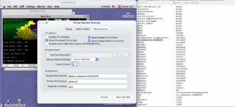

Ok, this should totally be doable in SheepShaver with a WiModem232. I was able to hook up a wifi modem to my MacBook Pro using a USB to RS-232 Adapter and connect to my BBS via ZTerm. I physically attached the adapter, listed all the files in my /dev/ directory, found my adapter (cu.usbserial-A105ZATW) in the list, and added it to the Modem Port Device Settings in SheepShaver. For whatever reason, setting up the serial port the same way in Basilisk II doesn't work, as reported by others...
Well now this is interesting! Bummer about it not working in Basilisk, that runs significantly faster for me.
Question - is the device name in your filesystem static? I.e., can it be set and forget, surviving reboots?
