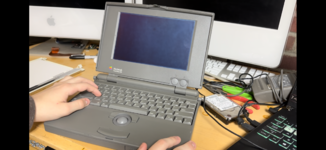

IT’S ALLIIIIIIIVE!
I seriously can’t believe it. Not sure what changed, all I did was fiddle with the reset/interrupt buttons, then I walked away for a second, came back, and it was just running! No sound, likely due to those 2 missing caps, but the system’s running! Brightness dial also doesn’t seem to work, hmm. I’m extremely happy right now, I really truly expected to end up with it having the black screen issue, but it seems I’ve lucked out.

And finally, here’s a startup video I made:
PowerBook 100 (Now with a chime!)
