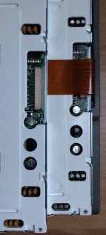

Before and after capacitors replacement :
The two SHARP display are very similar, like your picture, but the ref is different.
