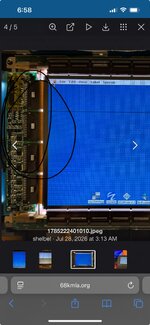

Then the flicker started. Not a backlight flicker, like the render would get wonky in various way. Sometimes for just a flash, sometimes for a few seconds. Its not the typical bad capacitor distortion, like it shifts the color gamut of the display in a somewhat uneven way. Sometimes it washes out the screen. Sometimes it blue shifts everything. Not sure how to really qualify it but heres a shot of one instance (from later in my story, but same behavior).

So, I pulled the display apart and started probing. I noticed what looked like a marginal joint on the 3rd pin of the 2nd tab. When I probed it, the entire horizontal driver bus collapsed, and stayed collapsed. Nothing usable on the screen.
With the display off, I noticed that pin 3 on the other 3 tabs short to each other, but not the suspect pin. I tried tracing that pin out, and made it to the AC04 chip in the top left corner, but that chip seemed stable. Then I realized that C40 above the top tab grounds to pin 3 on the other tabs but not the faulty one. I tried tracing that path directly, and got as far as (i think it was) D2 -> mystery 100 ohm resistor -> C40.
I also scoped all pin 3's and learned that the faulty one was running ~8.3v while the others were ~1.9v. I wound up bodging the X11 transistor (first stop off tab 2 pin 3) to C40. And that fixed the collapse, but got me right back to square one, line and flicker with the same behavior as before (and 12v restored to all pin 3's)
With my scope attached, I realized that the 12v feed to the tabs has a -5v drop during the flickers. That same -5v is measure on the other side of C40. Its neighbor, C35, measures a -2v sag. And thats as far as I've been able to make it after spending the better part of the past two days on it.
