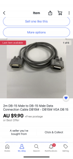

Hi all - revivifying an old thread, but I’m also keen to find an answer to this question. Is the Mac monitor DB15 to DB15 cable just a straight through thing or something more complicated?
The cable is straight-thru. One thing to be mindful of is that all the pins should be present and wired on the cable. Apple shipped the AppleColor RGB monitor for the Apple IIgs with a DB-15 cable that is missing pins and it will NOT work with a AppleColor High Resolution Monitor. The Apple IIgs doesn't use the sense pins on the DB-15 connector, so Apple saved a few cents on the cable by eliminating the unused pins.
