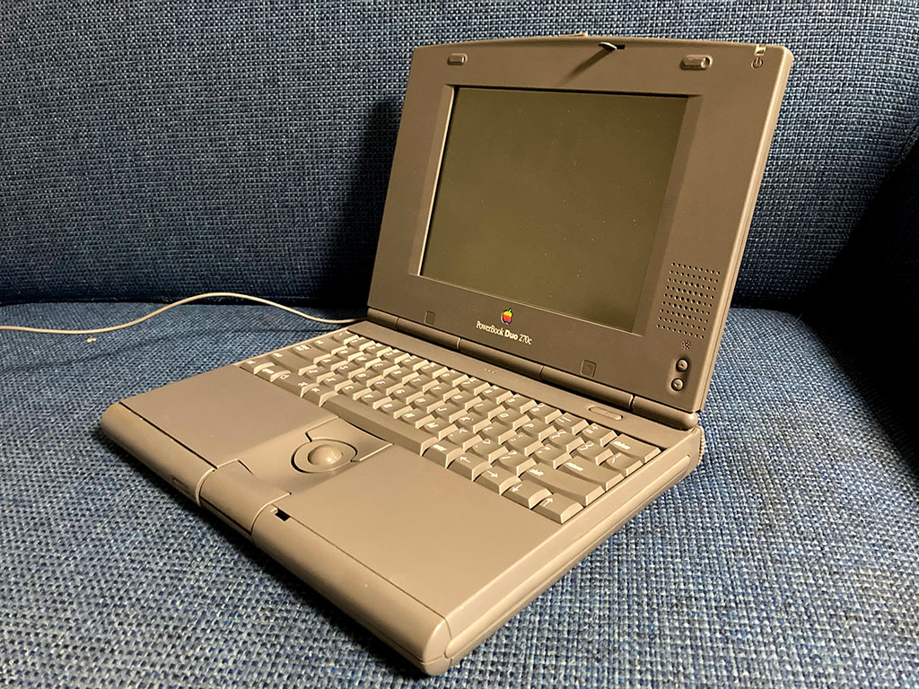

As mentioned in my "Duo 270c: Yay or nay?" post, I made the 70-mile journey to Overland Park, KS yesterday to pick up this PowerBook Duo 270c. It came with the power supply and a battery, but nothing else - unfortunately, no docking station. It appears to be in pretty good condition, but I haven't looked at it too terribly much (I was exhausted yesterday after returning, and have a lot to do today and these next couple days.) As per everyone's advice, I'm not going to attempt to power it on until I have it recapped due to the supposed risk of shorts that can fry some 5 volt components.
I try to do "introduction" posts on my blog about all of my finds, but this one will probably have to wait. My followers on Twitter (and the people reading this and my 270c post, obviously) know that I've picked it up.
My 68030 machines now outnumber my 68000 machines... 3-2.
