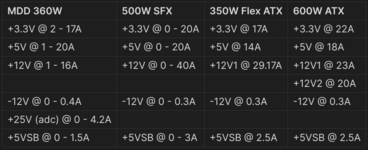

This are the specs of the 360W MDD PSU, note relatively high amps required on +5V (many new PC components have high +12V amp requirements). Do your replacements conform approximately to this?
Noting you had better luck with a 350W SFF PSU (which might be older with higher amps on what you need), unless you have a card in every slot, a HD in every sled, a high-end GPU with additional power required and some sort of super G4 upgrade, 350W is sufficient.

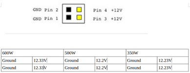

so I have just checked all the PSUs and they're pretty much all the same voltage-wise:
except the 600W one (the one that works) has an extra +12V listed?
I found an image of the dc output for the acbel supply and it has the same voltages as the image you posted and is 360W so I guess I had a 360W PSU originally. Below is the image:
This has just made me more confused as to why the 600W one works as all three PSUs have two +12V rails (at least according to the below image)
